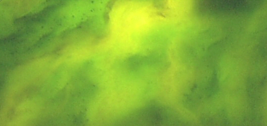

Left field, maybe even the left quadrant of Alpha Centauri:
Jade. Nephrite Jade.
OK, it would be quite a bit more difficult to file than even fossilized ivory. But it has legendary toughness, and when struck it sounds like ... well, er, like striking a hard stone. Jade can be olive green to bright green, and white (though the pure white stuff is very expensive.)
Eventually, I will try some, and then I guess I'll finally know if it is an interesting idea or just plain nuts.

Dennis,
My wife and I are jade collectors. Fascinating thing about jade is it first had value as a material for knives, axes, and weapons because of its hardness. Later, the weapons aspects of jade became more ritualized as it became more ornamental in nature, and from there it evolved into pure ornament and jewelry.
But the reason for jade's original value was its hardness. Typically 6-6.5 on the Moh's hardness scale, nephrite is characterized as being a very tough mineral due to its fibrous texture and interlocking grain.
It will require rather specialized lapidary equipment to grind jade due to its hardness. Also, with a specific gravity of 1.6 or so, it might be borderline heavy, but probably not too bad.
But you're right abour one thing -- it rings like fine crystal, and I'm sure its acoustic transmission properties are excellent. Good jade is not cheap, though. You could probably achieve very similar results with agate or quartz.

Michael,
I have seen some very thin-walled bowls lathe turned from jade, and when I remarked to the maker how amazing it seemed, he showed me his belt buckle. Unlike a typical lapidary belt buckle made from metal, with a stone cabochon, his entire (thinly carved) belt buckle was jade. He said he had worn it for years, and told me that jade is extremely tough.
Now I know that it is the interlocked crystalline structure that makes jade so tough.
I have gemstone faceting equipment, so I could get the saddle ground down to the proper size. (Carborundum sanding belts would work also.) I think the most difficult thing will be grinding the saddle for intonation compensation. That might require a small diamond-charged file.
At the size of a saddle, I think agate and quartz would be much more prone to breaking than jade. Plus they are both harder than jade, adding to the difficulty in filing for intonation.
